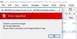

My next question is get this error report when I try to program with breakout via the dev board,what should I do for this?

    For your second question, it just looks like your board isn't connected to the computer. How are you connecting the board? Is the board powered on?
    For this I'm powering up the same way they have mentioned in the hookup guide for the sparks-fun breakout board  link here
    this whole thing worked for a while i even tested some of the examples and then started getting this error message
    please help on this
     This is strange. You are sure both boards are powered on and working? Could you send me a picture of your set up?
