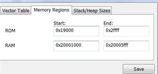

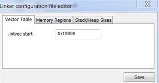

We are using NRF52810 with latest nRF5_SDK_16.0.0 and s112_nrf52_7.0.1_softdevice. We are able to program with ble_app_UART example on our prototype,
but BLE is not advertising. here are some snapshots of our project configuration.

  • I have added debug in Pre- Processor
    As well as while debugging i found insufficient RAM
    Is there RAM Allocation issue?
    I have also tried with different flash and RAM allocations, but it still fails to advertise.
  • If it lands you on this warning then, you are allocating less RAM to your application.
    Try viewing exact size of the RAM displayed by NRF_LOG and allocate that size.

    I think i resolved the RAM allocation issue. because i am not facing nrf_log_warning for maximum ram allocation.
    But i still not got BLE advertising packet  and device again goes into hardfault after 5 6 seconds.
