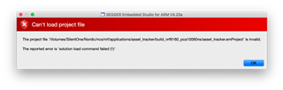

New nRF9160 DK, and I'm unable to create the build environment and open the application sample in Segger.
I followed the issues from https://devzone.nordicsemi.com/f/nordic-q-a/54149/error-by-loading-solution-on-ses, which fixed the zephyr script issues, but was seeing the same problems at the end of this discussion.
I installed branch v1.1, as per the suggestion.  I re-ran the zephyr install script, which completed.  However, I'm seeing multiple errors running the script:
pip3 install --user -r nrf/scripts/requirements.txt.  I'll list the error log below.
Also, if I quit SES, I have to re-install the license when re-opening every time.

  • Still no luck.  Same error modal, with the same error log, re. "import six".
    The git checkout master had failed, so I started with a fresh ncs installation, including the script updates.

  • Yes, I'm using the latest version.
    when I re-run pip3 install west, the output says:
    Requirement already satisfied: six in /Applications/Xcode.app/Contents/Developer/Library/Frameworks/Python3.framework/Versions/3.7/lib/python3.7/site-packages (from configobj->west) (1.12.0)
    I'm a long time Xcode developer, so it makes sense that there's python in the Xcode toolchain.
    As part of this installation, there is also a python 3.7 installation in
    /Users/jeffkase/Library/Python/3.7/lib/python/site-package
    And, that may be where SES is looking for six (it doesn't exist in that location).
    What path does python use for finding scripts/tools?
    --jeff
  • I copied the six.py and the dist directory over to the ~/Library/Python/3.7/lib/python/site-package directory, and SES can now open the project!
    I would recommend you to only have one Python/3.7 folder or only include the path to /Library/Python/3.7 into your system variables, such that when you use the commands pip3 and west it will run from /Library/Python/3.7. Then when you use SES, it will find the packages.
