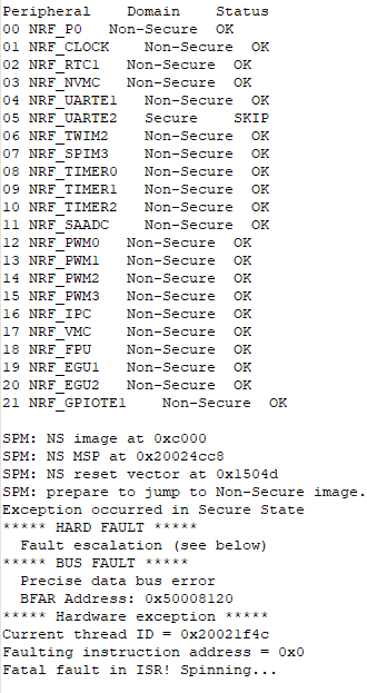

nRF9160 HARD FAULT Current thread ID = 0x20021f4c
Hello:
    I enabled LTE and GPS in my project and I encounterd a terrible hard fault error.
    The error didn't happed once I programmed my hex file.
    It work fine but hard fault accur two days later.
    I can't recover it even reprogram it with normal hex file such as at_client.hex.
    Finally the hard fault solved after I update "mfw_nrf9160_1.1.0.zip".
    PS. The original modem firmware is  "mfwnrf9160100.zip" on the hard fault devices.
