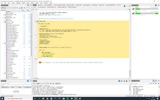

I am working with ANT bpwr tx profile and trying to implement HX711 and TWI sensor to it. TWI sensor is already working, but when I add library for HX711 from  and start sampling HX711, the ant transmission looks like it stops transmitting, or lose all packets. I can see it in AntWare II, that when hx711_start(false) function is called, AntWare can not see any transmitting device and i can see data from hx711 printing in debug terminal, but when I comment this function and let it how it was before, AntWare II can see the device and is able to receive data, so i know, that there is some conflict between hx711 data sampling and ant+ data transmission, but the project compiles succesfull. Do somebody know, what might be the problem?
using nRF52832, SDK15.2, Segger embedded studio, and library written by Vidar
thanks in advance

    Are you testing this on a Nordic DK? I'm wondering if maybe the continuous sampling interferes with the radio. Please try and see if it works if you only call hx711_start(true) once.
    Vidar
    Solved it by moving hx711_init() and hx711_start() to the beginning of main function before code lines that handles start of softdevice and profile initiation.
    And yes, i am testing it on nRF52832 DK and when i wrote hx711_start(true) it didn`t work too. But now, when it is placed before softdevice and profile initiation it works.

    It shouldn't be necessary to initialize it before the Softdevice. I think you will need to debug the app if you want to find out why it's required in your case.
