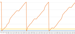

I have test setup consisting of 2 boards, one that sends a packet every 2 seconds with CTE, and another with a 2-antenna array that generates MagPhase samples and sends them to a serial port so that I can save and plot them. I'm running in AoA mode, switching between the 2 antennas every 4us. I am sampling every 125ns, so I get 32 samples on each antenna. I'm keeping the sample rate high for now so that I can see the phase slope shifting as I move the transmitter.
My question concerns the phase changes around the antenna switch events. I expected to see a fairly obvious jump in the phase, especially as the 125ns sample period is much longer than the 10-20ns or so switch-over that my switch should have (using a HMC194AMS8E), and the rise and fall time of the control lines are approx.10ns. Instead I am seeing what looks like a filtered transition, spread over approx 12 samples, or 1.5us, like this:
The orange lines correspond to the switch transition points, roughly.
Does anyone have an explanation for this? Is it something to do with how the phase is calculated from the IQ samples?

    Thanks for the reply but I think my question has been misunderstood. I realise that there is always a shift between the end of the reference period and the first sample in the switching slot, but I'm I'm referring to the shape of the phase that I'm seeing at all switching transitions. My selected RF switch is supposed to have a settling time of around 10ns, so I expect to see clean phase changes at the transitions (as the path lengths to my 2 antennas are different) but I see a very slow, distorted transition, lasting almost 1.5us, which I've circled in yellow in the figure in my original post. I've tried changing the drive to my switch control lines, and reducing decoupling capacitors etc. but nothing improves it. I'm wondering what is causing it. I expect to see something more like this, which Dmitry posted elsewhere:
    Regards
    Pete

  • Thanks Bjørn. I've noticed that the signal magnitudes I get from my 2 antennas can easily differ by 10dB or more (my test environment is quite cluttered so I probably have lots of multipath), so I'm wondering if what I am seeing on the phase plot is caused by the settling time of receiver AGC, since the settling time I see on the magnitude graph following antenna switch-over is of a similar duration (approx.1.5us). That's impressive but it does explain why we need an allowance for switchover, although maybe 1us is not quite enough.
    Regards
    Pete
