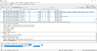

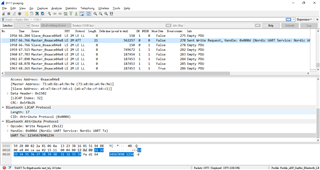

Not able write more than 13 Bytes data (while write 14 Bytes, My application stuck) into My applcation with nrf_connect android application
In nrf_connect android application shows log in "Log 2020-01-17 11_37_48.txt"
[Central][Log in nrf_connect android application]
1). write 13 Bytes, result: PASS
V 11:37:05.688 Writing request to characteristic 6e400002-b5a3-f393-e0a9-e50e24dcca9e
D 11:37:05.688 gatt.writeCharacteristic(6e400002-b5a3-f393-e0a9-e50e24dcca9e, value=0x31323334353637383930313233)
I 11:37:06.088 Data written to 6e400002-b5a3-f393-e0a9-e50e24dcca9e, value: (0x) 31-32-33-34-35-36-37-38-39-30-31-32-33, "1234567890123"
A 11:37:06.088 "1234567890123" sent
2). write 14 Bytes, result: NG
V 11:37:28.334 Writing request to characteristic 6e400002-b5a3-f393-e0a9-e50e24dcca9e
D 11:37:28.334 gatt.writeCharacteristic(6e400002-b5a3-f393-e0a9-e50e24dcca9e, value=0x3132333435363738393031323334)
D 11:37:32.522 [Server callback] Connection state changed with status: 0 and new state: DISCONNECTED (0)
I 11:37:32.522 [Server] Device disconnected
E 11:37:32.538 Error 133 (0x85): GATT ERROR

My application not show any evt in nrf_ble_qwr_on_ble_evt fuction, I guess while handle 14 Bytes data write request in softdevice has exception.
Please Nordic help to provide me the way to do next debug

    Wireshark log "0117.pcapng"  attachedfor reference.
    [Wireshark log information]
    [Master Address: 73:e8:6b:a4:9e:9e (73:e8:6b:a4:9e:9e)] <- nrf_connect Android Application
    [Slave Address: e6:e7:6e:cf:b4:c1 (e6:e7:6e:cf:b4:c1)]  <- nrf52832 wtih my application
    1). Master writes 13 Bytes into Slave successfully
    [Write 13 Bytes][OK]
    2). Master not able to write 14 Bytes into Slave, and lost connection
    [Write 14 Bytes][NG]
