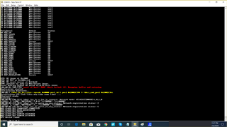

    Connected back to USB to observe the console logs and observe the Errors (UART issues)
    The screenshot has been captured and attached.
    Another issue, we often observed is,
    After we porting the changes (nrf.diff and zephyr.diff for v1.1.0 branch) given on the other thread, we are able to see the following errors:
    [00:00:00.946,105] <err> bt_driver: Unknown H:4 type 0x92
    [00:00:00.946,105] <err> bt_driver: Unknown H:4 type 0x00
    <wrn> bt_driver: Discarding event 0x3e
    We have observed these issues when we tried to test thingy91 for a long time like 5Hrs. Once this warning started popping, other tasks are not working (For example GPS, Flip).
    After some time, the device getting disconnect with the nRF cloud.  The device never comeback to recovery by itself.
    Need a manual power cycle to get the device back to the normal state.
    From the above, we can see/understand that the HCI_UART interface is not working as expected and the behavior of BLE is unknown in Thingy91 (PCA20035).
