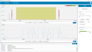

  • Hi Anthony,
    my reply and its thread got deleted by  mistake. Sorry about that.
    What you said is correct, sorry for not seeing that the first time. The vApplicationIdleHook was being called too frequent to keep the logger thread active most of the time and your suggestions actually reduced the power consumption when logs are enabled.
    Without your change, the vApplicationIdleHook was unblocking the task that in turn tells the scheduler to abort the idle sequence. I thought that the scheduler will run the logger_task and resume the idle operation but then it would become a chain of block and unblock and the control never reaches to sleep.
    SDK example without changes and logs enabled.
    Anthony's change, the power consumption goes down
    Attaching the files with changes suggested by Anthony.
