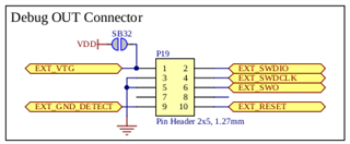

We have our first prototype ready and were measuring the power consumption. During development the values seems to be wrong.
So I just added a voltmeter to the DUT out clamps and put the switch into external position. Surprisingly I measured 2,28 V. How could that be? No external supply was present? Even when I put a 3 V supply to the "External supply" I measured 2,28V? Where does this voltage come from? In my opinion there should be noting?
The second try was to disconnect the DK from the PPK. I connected the two board with a 10pin flat cable, soldered the SB32 on the DK to switch to the external device, and supplied 3,2V from external. The output of "External DUT" was always 2,8V.
Thanks for your help.
Parents Reply
  • If you soldered SB32 there will be a short between the supply on the DK and the external supply. If the voltage difference is high there will flow a lot of current and you will probably break some components.
    If the following steps do not work, it sounds to me that some components on the PPK are broken because of the supply short.
    • Set the "Power select" switch on the PPK to the "External" position
    • Set the "DUT" switch on the PPK to  the"External" position
    • Connect SWD cable from DK to PPK
    • Connect USB cable to both DK and PPK
    • Supply 3V on the "External supply" pin
    • Finally, you can open up the PPK software
