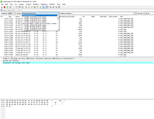

  •  Thanks Edvin!!! that worked. I am capturing BLE traffic now.
    Thank you for all your assistance, you have enabled me to start developing.
