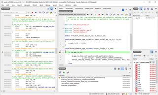

It runs and responds to commands, but when paused or hits breakpoint - single step or continue gets to address 0xa60, continue logs the message:
app_error_weak.c,   96, Softdevice assert: 154516:0
Are there some required debugger setting whne debugging with softdevices?
I was debugging sample project without the softdevice without problems - possibly there is another issue.

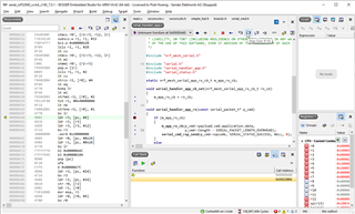

    Included two screen shots: after stopping on breakpoint, and after continue. Do not know if you could see graphics in the post, so adding those two pics as one zip.
    If I do single step in asm mode, it debugs correctly, but stepover in source is causing this exception.
    If you step in asm mode, you just issue single step to the debug logic on the core, with source stepover, most likely they insert temp break at the step target address, then run. Any run is causing probably this exception - possibly caused by pending interrupts in the exec pipeline.

    If you set the breakpoint on main.c:155, run,, first src stepover is OK, second stepover generates the exception.
    I am using Segger 4.42, with latest firmware on the 840DK

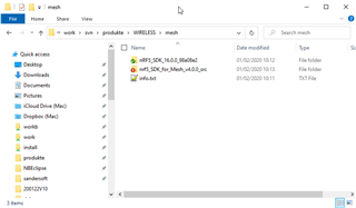

  • For reference, here how I have unzipped SDKs on my HD, and serial example is in its original "mesh sdk" location:
