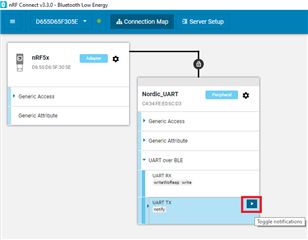

  • hEyall,
    I don't know what you are connecting with, but if you use nRF Connect for Desktop, it should look something like this:
    If so, you should press the "play" button next to UART TX.
    If you use nRF Connect for Mobile, there should be an icon with 3 arrows pointing down next to the UART TX characteristic. Press that one, and it should start updating the characteristic when you write to it.
    The line "....is sent to the peer on handle 0x12" isn't originally in the project, so it must be something you have added. But it looks like this is just the connection handle of your connected device. What does it look like where you print it?
