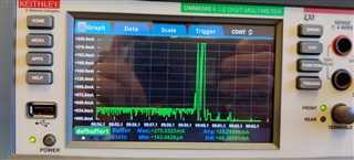

  • Hi again
    I had some trouble getting the data from the measuring unit. But it seems you may be right regarding the TX peaks. The picture below depicts the modem idle current of ~30mA, a TX peak and afterwards the modem off period. The measurement was done with the PSM RPTAU set to 1 hour.
    Andreas
  • Hi Andreas,
    Hard to see how long that RX period is, as the instrument does not log before 0854, but it seems to already be 6 seconds.
