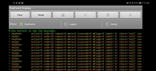

We're working on a ble hid keyboard project, and we need some clarifications on how the keyboard keys press/release is done !
We've started with the example in the sdk v16.0.0, the example uses the keys_send() function to send a press followed by a release of that key.
In this function there is  send_key_scan_press_release() , and i think this is the responsible for sending a press followed by a release of the key.
In our use case, we need to send just a press when the button is pushed, and a release when the button is released. in this case a hold on the button will output a successive key presses , and when released it will output just one release . this is achieved with the USB keyboard version using the app_usbd_hid_kbd_key_control() function.

the BLE  hid keyboard output on the host, should be as in the picture bellow (same as with the USB version) :
USB hid keyboard log
Any help, clarifications, recommendations on how to achieve that is highly appreciated !

    If you wait more than 500ms between key press and release, then at least for Windows it will treat this as a key repeat automatically until release it received.
    I have experimented with the send_key_scan_press_release() function, just sending a one key, and not even using the buffering feature.
    For the press i just fill the data array with the scan code (1 key_pattern). and for the release i clear the data array.
    The BLE HID output seems to output a KEY PRESS followed by KEY RELEASE, a hold on the button will keep outputting a PRESS followed with a RELEASE.
    I even tried to only send a PRESS (by not clearing the data array); but that also sends a RELEASE after.
    I'm not quite sure how the RELEASE event is sent right after the PRESS, even without clearing the data[] variable!
    I Really appreciate any hints/guidance/documentation on how to implement it.

  • Have you tried to call ble_hids_inp_rep_send() when pressing, and then ble_hids_inp_rep_send() when releasing directly?
    Just make sure that the data buffer is 8 bytes, where the first 2 bytes (data[0] and data[1]) are key modifier (e.g. shift, num lock etc), so the actual key that is pressed is 3rd byte (data[2]) in the array. The remaining data bytes (data[3]-data[7]) can be 0.
