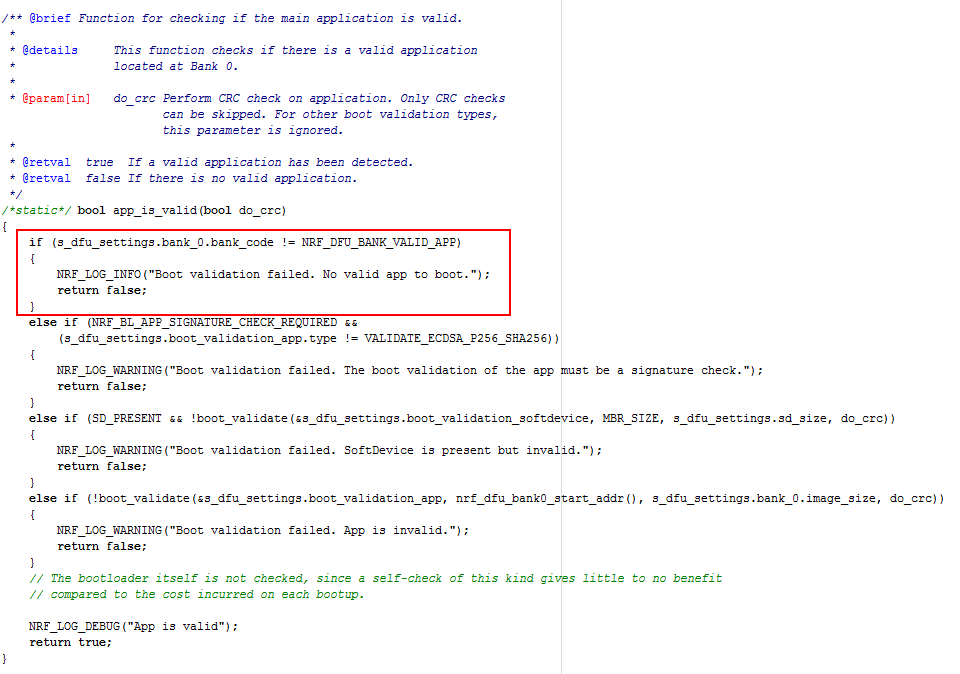

  • Hi Chibi,
    Could you please also post how you generate the bootloader setting ?
    If the bootloader setting is not generated and flashed properly, the bootloader won't jump to the application.
    When you said you programmed the blinky example and it didn't work when the bootloader is flashed, how did you program the blinky example ?
    Did you do DFU to flash the blinky example or you flash it directly ?
    You can enable logging inside the bootloader to have more information.

  • Please check sdk_config.h file to see if NRF_LOG_ENABLED = 1 ?
    Also make sure you erase the chip before testing with the debug bootloader as the address of the debug bootloader is different from the normal one. The chip need to be erased if you want to change bootloader address.
