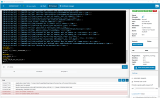

I have designed my own board, based around the nRF9160 but unfortunately I am unable to connect to an LTE network.
I am running the at_client code and using LTE Link Monitor. Below, is the log file.

I have used the same SIM in the nRF9160DK and I do get a connection, all be it very weak. I am only seeing 1 bar in the LTE

  • Hi Rod,
    it might be that the antenna is too close to the ground to the right, but the antenna datasheet does not specify anything in this regard so it is hard to say. Have you had the antenna manufacturer look through the design as well?
    You might just need to tune the components values on the matching network.
    Kaja

  • Hi Kaja,
    Ok, a bit more investigating and it looks like my board has the NBIOT only part fitted. I have an nRF9160-SIBA fitted. (I see the nRF9160DK has the - SICA fitted) So, am I correct in saying that my board will only support NB-IOT? (and not LTE?)
    Can I still use the LTE Link Monitor to connected to NB-IOT?
    What changes do I need to make to the AT commands?

  • Hi Rod,
    yes you talked to me about the HW. But as I said in the previous answer, you need to tune the antenna for your specific board.
    The impedance of the antenna will change from design to design, because things are not always exactly the same.
    If you have a look at this:
    9160Ant.pdf
    This just means that you have to adjust the values of the matching components, so that the antenna is matched to 50 Ohm, withing your chosen freq. band, based on your specific board.
    What I have done, is added ground on the DK, to have the same placement as in your design, just to see how "de-tuned" the antenna gets.
    We still get okay signal strength, and connection shown in the LTE Link Monitor:
