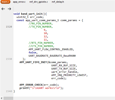

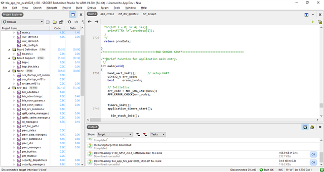

Here is a screenshot showing our main.c and our main() custom code.

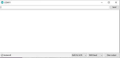

It seems like the first function call, the UART call, in main() does not even get executed when we use SES' Build and Run command. The custom NRF51822 board is connected via COM11 and we are listening to any UART output with the Arduino monitor. We also checked the baud rate and it is correct.
But after we click Build and Run in SES, we wait and nothing comes through the UART from the custom NRF51822 board.

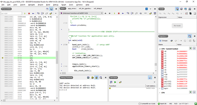

We verify that the custom code does get successfully executed and works when we use SES' Build and Debug command. Attached below is the output when we run Build and Debug.
