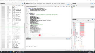

Our application sometimes hits a breakpoint in SoftDevice at either address 0xA60 or (less often) 0xA80.

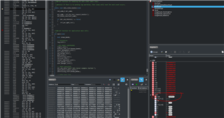

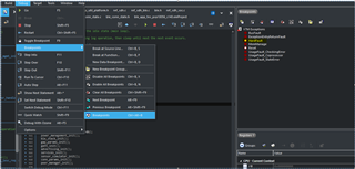

    0xA60 is where the hardfault handler is located in the MBR. Please disable the breakpoint on hardfault as shown by the screenshot below (assuming you use SES) and check if the program enters the hardfault handler in your application or if it ends up in the app error handler.
