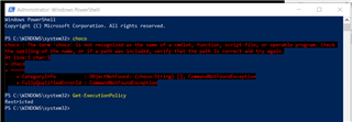

    • If you run choco, you can see that it's not installed:
    PS C:\WINDOWS\system32> choco
    choco : The term 'choco' is not recognized as the name of a cmdlet, function, script file, or operable program. Check
    the spelling of the name, or if a path was included, verify that the path is correct and try again.
    At line:1 char:1
    + choco
        + CategoryInfo          : ObjectNotFound: (choco:String) [], CommandNotFoundException
        + FullyQualifiedErrorId : CommandNotFoundException
    • Run Get-ExecutionPolicy:
    PS C:\WINDOWS\system32> Get-ExecutionPolicy
    RemoteSigned
    In this case, I did not get "Restricted" in return, but if you do, please tell me and I will look into it.

  • Hi Simon,
    Thanks for your help.
    I do get "Restrictred" message,
    Please help, regards mike
  • Try running one of these commands before running Get-ExecutionPolicy:
    • Set-ExecutionPolicy AllSigned
    • Set-ExecutionPolicy Bypass -Scope Process
    Then continue with all the steps shown below.
    If that doesn't solve your problems, please tell me.
    I am sorry for the struggles, but I will help you getting this to work and will not give up until you've made it.
    Simon
