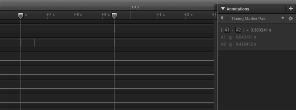

    Could you try again with ACK_WAIT_TIME set to 5.0 in dfu_transport_mesh.py  and recompile nrfutil?
    I had a look at the UART trace and it's pointing out to the long delay when the chip has to erase multiple pages in flash (for the swap bank).
    In my case I'm testing with an image with size of 160kB meaning it's 40 pages. The time it take to erase a page can be up to 89ms. This result a CPU busy time of up to 3.56 seconds. The ACK_WAIT_TIME by default is 0.5 second and the nrfutil will try to send the message again.
    Because the CPU is busy when doing DFU, it seems that the UART packets are hang due to HWFC and it only continue when the CPU finished with flash erase. And after that the nRFUtil is confused and will stop.
    You can see the screenshot here:
    The small pulse in the middle is when the nrfutil tried to resend the packet but couldn't finish due to buffer overflow and HWFC stoped it. The time from A1 to A2 is 3.38s matched with the erasing time for 40 pages.
    I will check with the Mesh team to get a confirmation. Before we can have the official fix from the team, the workaround here is to increase the timeout to 5 seconds so that the CPU have enough time to erase the flash. 5 seconds is enough for an image size of 224kB. The draw back of this is when a packet is dropped on UART (which don't usually happens) it would take 5 seconds before the nrfutil retransmit the packet.
