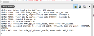

  • while running i am getting this in debug terminal ,
    but i couldn't able to connect to the device , i switched to timer 3 for adc and timer 1 for one pwm . It is advertising continuously even i can't able to connect

  • What happens when you try to connect? Does it say something in the log?
