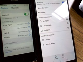

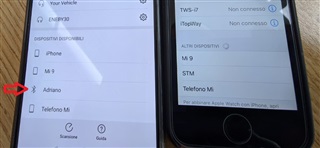

Now I tried to make same application under IoS, but my my DK device is not on the availaible BLE device list (I tried with SE and S7 iPhone).
Here below image showing Android and iPhone screen (red arrow on Android phone shows my device)
Where I wrong? Have you any suggest about?

    In the image here below (left side) "Adriano" advertising details reported on nRF Connect.
    Yes, if I use nRF Connect on IoS I can see and connect my "Adriano"
    I tried also using nRF5_SDK_16.0.0_98a08e2 ble_app_blinky example on DK board and nRF Blinky on iPhone. Same result, the Nordic_Blinky device is working but it is not on the iPhone Bluetooth device list (image below, rigth side)

    I don't know why it shows up on your android, but perhaps that same DK was bonded at one point, and the device is stored in the bluetooth settings.
    By default, very few BLE devices show up in the OS settings -> Bluetooth section. It will filter out anything that doesn't look interesting.
    If you try to flash the ble_app_hids_keyboard example to the DK, I guess you will see it in the bluetooth menu for the iPhone.
    The way people usually work around this is to have a custom application that scan and connect to your device (like you are able to do in the nRF Connect app). The issue is not that the phone doesn't see the device, but that it doesn't advertise with any standard bluetooth services that looks useful for the phone, such as a keyboard or a headset, it will not be listed in the bluetooth section of the OS settings, unfortunately.

  • Many thanks Edvin! The ble_app_hids_keyboard is shown on the iPhone device list.
    In other words, if I well understand, there is no issue on application. The "not useful" BLE device not shown is a normal behavior of the BLE interface on iPhone IoS, right?
