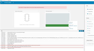

When I program my pca10059, I get error below.Actually, I do not know if the PCA10059 have been programmed successfully.After the programming ,The PCA10059 disconnect with PC and do not do anything untill it be reset again and go a state which  red led flash.  It is quite clear that the server code do not running.

    After the programming I read the device like below:
     The messages you get there saying that you it can't find the device will come unless the application uses the USB peripheral on the nRF52840 dongle.

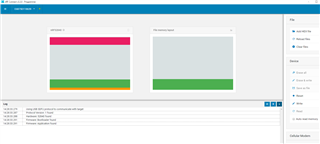

    I connect my pca10059 to PC by USB, and I can program the example of blinky which is in  "\
    ..\nRF5_SDK_16.0.0_98a08e2\examples\peripheral\blinky\pca10059\mbr\ses"  to my  PCA10059  by the Programmer of nrRF Connect tools. I notice when I program blinky to PCA10059, I got same information, but  the blinky running well.

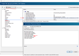

    4. Before building, I follow the "nrf52840 Dongle Programming Tutorial" post, modify the option of the project like below:
           a: Code-->Preprocessor Definitions: BOARD_PCA10059
           b: Linker-->Section Placement Macros :   follow the "nrf52840 Dongle Programming Tutorial" post

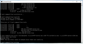

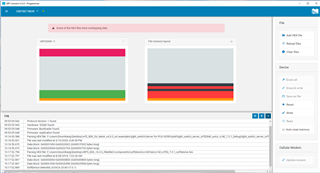

  • Hi Edvin
    I just had a question. I was able to successfully program the BLINKY example for DONGLE and it worked fine, but I couldn't successfully get the server code for the light-switch example to run on DONGLE. Is this because the blinky example does not require a soft device and the server program does?
    If the answer is yes. I have few question below.
    1. After a project be built in Segger Embedded Stuido, the soft device, Whether the soft device has been added to HEX? Because when I program code to PCA10056 , it do not need a extra soft device's hex. So I think the soft device's hex have been add to the hex of project. Is it ture or not.
    2. I want program a HEX file of project which need soft device and be built in SES to Dongle by Programmer tools, whether a soft device's hex need.
    3. If I need add a soft device with project's hex ,when I program the dongle by Programmer tools, if I need merge them by mergehex tools or I just add the soft device's hex and project's hex to Programmer tools?
    Dison

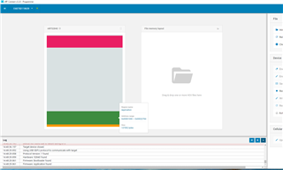

  • If you usually use Segger Embedded Studio to program your DKs, the Softdevice is automatically added. If you go to your project settings in SES -> Debug -> Loader, you can see that it links the softdevice under "Additional Load File[0]".
    If you program using nRF Connect for Desktop -> Programmer, it doesn't automatically add the softdevice.
    1: I think that answers question 1.
    2: Yes. You need to manually add the softdevice if your application requires it. And if it is an example from the Mesh SDK, it does indeed require the softdevice.
    3: Well, it is possible to merge the two hexfiles using the mergehex tool (part of nrfjprog / nRF Command Line Tools. command: "mergehex -m file1.hex file2.hex -o mergedhex.hex".
    Alternatively, just drag and drop the softdevice from the SDK into nRF programmer, together with your application file, and it will program both the application and the softdevice.
    The softdevice is located in: SDK16\components\softdevice\s140\hex\s140_nrf52_7.0.1_softdevice.hex (use the SDK that you use together with the mesh SDK to get the compatible softdevice version).
