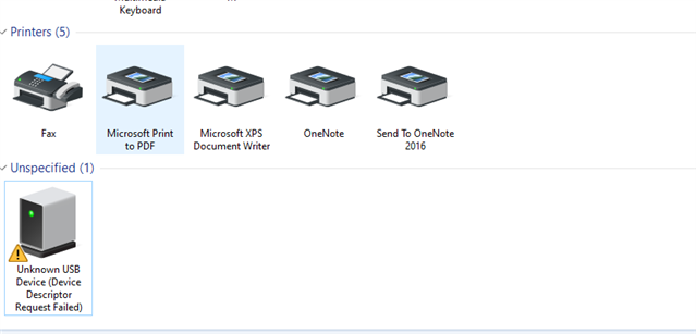

I am using nrf52840 dk for zigbee project with two xbee modules. One xbee is configured as coordinator and other as end device and nrf board is supposed to act as router. After setting channel and pan id from cli when I enter bdb start , command prompt just hangs .
Parents Reply
  • Is the DK powered? Any LEDs blinking? Try to power the DK with a separate USB cable through the programmer USB.
    Alternatively, there are some switches on the DK on which you can choose to power the DK with the USB peripheral. I believe you only need to set the nRF Power Source switch (close to the programmer USB port) to USB, but I can't double check this now. (Home office due to the pandemic , so I am using remote desktop and don't have physical access to the DK, only programming/logging).
