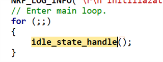

Reduce current in Low power mode
My task is..
Device will advertise for 20 seconds if there is no connection then it will go to sleep mode for 40 seconds. After 40 seconds it will wake up from sleep mode using timer interrupt and start advertising again for 20 seconds, This cycle continuously runs until device makes BLE connection.
I want to enable sleep mode and minimize current consumption in sleep mode.
I have used following APIs to put device in sleep mode.
sd_power_mode_set(NRF_POWER_MODE_LOWPWR);
sd_app_evt_wait();
But even though, it is consuming 170-230 uA current in sleep mode.
Any idea how we can reduce current in sleep mode. Is this correct method to enable sleep mode with SYSTEM ON ?
I have attached Main.c file of my code. Sleep_mode_enter function is used to enable sleep mode when advertising IDLE event triggered from softdevice.
Please let me know as soon as possible.

  • Hi Thank you for your quick response.
    Below are code changes which I need to make.
    In my while(1) loop function idle_state_handle()  is getting called so, when there is no event CPU is in sleep mode only.
    Low power mode is enabled by default so no need to set it explicitly.
    I have used standard development kit for this demo. So, all BSP initialization is as per standard DK only.
    I have not called bsp_init function. So, my GPIOs are not initialized as I don't need any GPIO configurations.
    I want to run timer in sleep mode and wake up after specific time interval.
    Can you please suggest how can I proceed ahead to reduce current to less than 50 uA.??
  • Hi Mihir
    I think you should initialize the buttons and LED's even if you're not using them, otherwise you could have issues with floating pins as I mentioned earlier.
    For sleep timing you should use one of the RTC timers, as they will run at a much lower current than the TIMER modules.
    The app_timer module in the SDK is also based on the RTC, and can be used to wake up the CPU at regular intervals while consuming only a couple of microamps in between.
