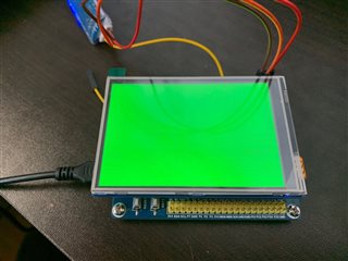

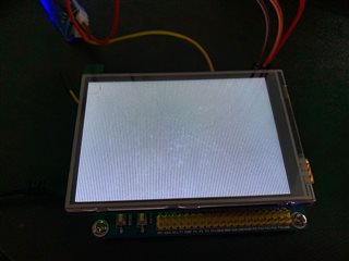

I am trying to use SPIM3 to drive LCD(ili9486), but I have encountered some problems, hoping to give me a solution.
I have 2 questions:
1. spi_config.dcx_pin
How to set this pin?I init this pin with NRF_GPIO_PIN_MAP(1,8),but it did't work,I need setup to NRFX_SPIM_PIN_NOT_USED and pull up or pull down this pin in manual.It very weird!
2.LCD_SetPointlColor not work, but LCD_Clear work well
I don't know why this happen,but it was real,I can clear LCD with LCD_Clear function to any color, but I can't draw any point wiht LCD_SetPointColor  funciton.It was my funciton write wrong?

LCD_Clear
LCD_SetPointColor
