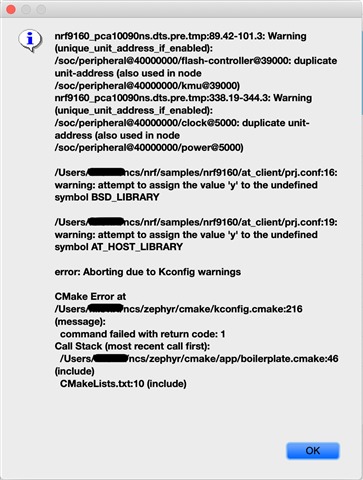

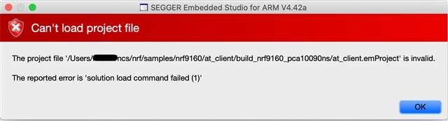

I am currently trying to follow the SDK instructions to get everything up and running. I followed all steps closely and didn't run into any errors apart from the last step.
When entering the nRF connection options in Segger I get the following error:
I tried v1.2 and the master branch, both won't work with the same error messages. I am on macOS Catalina, nRF Connect 3.3, Segger 4.42a, ARM 8-2019-q3-update toolchain.
Dependencies/requirements were installed successfully and I didn't have any errors while walking through the steps. I am a bit confused what would cause this. If more details are needed please ask :)

    Thanks for the response. I tried using the Actinius Icarus first (this is the board I have) and the nrf9160_pca10090. Both with and without the ns definition. It's the same error for all 4 scenarios. I have the feeling some dependency or something is missing, but I didn't get any error when going through the SDK instructions.
  • Do you get the same errors when building from the command line?
    Can you send me the output you get when using west from the command line?
  • Here is the output when running:
    west build -b actinius_icarus_ns
    -- west build: build configuration:
           source directory: /Users/nik/nrf/ncs/nrf/samples/nrf9160/at_client
           build directory: /Users/nik/nrf/ncs/nrf/samples/nrf9160/at_client/build
           BOARD: actinius_icarus_ns (origin: command line)
    -- Zephyr version: 2.1.99
    -- Selected BOARD actinius_icarus_ns
    -- Found west: /Users/nik/Library/Python/3.7/bin/west (found suitable version "0.7.2", minimum required is "0.6.0")
      File "/Users/nik/Library/Python/3.7/bin/west", line 5, in <module>
        from west.main import main
    ModuleNotFoundError: No module named 'west.main'
    CMake Error at /Users/nik/nrf/ncs/zephyr/cmake/zephyr_module.cmake:45 (message):
        File "/Users/nik/nrf/ncs/zephyr/scripts/zephyr_module.py", line 236, in <module>
          main()
        File "/Users/nik/nrf/ncs/zephyr/scripts/zephyr_module.py", line 200, in main
          returncode=p.returncode)
      subprocess.CalledProcessError: Command
      '['/Users/nik/Library/Python/3.7/bin/west', 'list',
      '--format={posixpath}']' returned non-zero exit status 1.
      /Users/nik/nrf/ncs/zephyr/cmake/app/boilerplate.cmake:458 (include)
      CMakeLists.txt:10 (include)
    FATAL ERROR: command exited with status 1: /usr/local/bin/cmake -B/Users/nik/nrf/ncs/nrf/samples/nrf9160/at_client/build -S/Users/nik/nrf/ncs/nrf/samples/nrf9160/at_client -GNinja -DBOARD=actinius_icarus_ns
  • Do you have libgit2 installed?
    We are also in the process of updating the macOs documentation. You can find the open pull request here: https://github.com/zephyrproject-rtos/zephyr/pull/23445
    P.S.
    I would prefer that you show the output of nrf9160_pca10090ns, not actinius_icarus_ns. That way, it is easier to compare to other issues.
  • Thanks for the suggestion, and yup, I installed libgit2 earlier via homebrew. Sadly the errors are still there.
    I also removed the ncs folder completely and ran through the steps again. But the same errors again in Segger as well as via the CLI. Hmm...
  • It's working now!! But don't ask me what I did, because I honestly don't know. Thanks for your help :)
