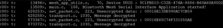

still when i try to get again the composion data it's failed, and if I try to send GenericOnOff messages - the provision device log (out trough the segger-debug terminal) "unencrypted data", means it couldn't decrypt the message (that isn't for self decrypt anyway, am I wrong here?).

    As mentioned, it's not supported to use only the JSON file to restore the database for now. As you already tried, you would need to add the device keys, addresses and the application keys to the node. You will see "unencrypted data" in the log of the serial board. But then in transport layer, you should see it's decrypted. Like this:
    Have you tried what I suggested, to set PERSISTENT_STORAGE = 1 in the serial firmware ? This way you can reset the board, start pyACI again and still can have everything working. (You still need to add the model to the device but that's all)
