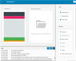

Unable to Perform a DFU over USB CDC ACM (the Bootloader never boots the new app)
For my all DFU i follow the steps on the Getting started guide , just in the Performing DFU step i use the nrfutil tool for the over USB.
First i tried with the DFU examples provided, i started with the open_bootloader , uploaded that to the nrf52840 dk after a full erase. and then use nrfutil to upload the blinky_mbr.zip package located in the secure_dfu_test_images folder. the package gets loaded to the board, i can see the uploading process over the Command line.but, after that the blinky_mbr app never gets started. the board just turns off all the LEDs , and when i Reset it starts in the Bootloader mode, it never jumps to the app. i still can see the the bootloader /app files in nrf connect.
I used the debug version of the bootloader, And here is the logging i get:
Starting from the upload of the bootloader till the end of the DFU.
