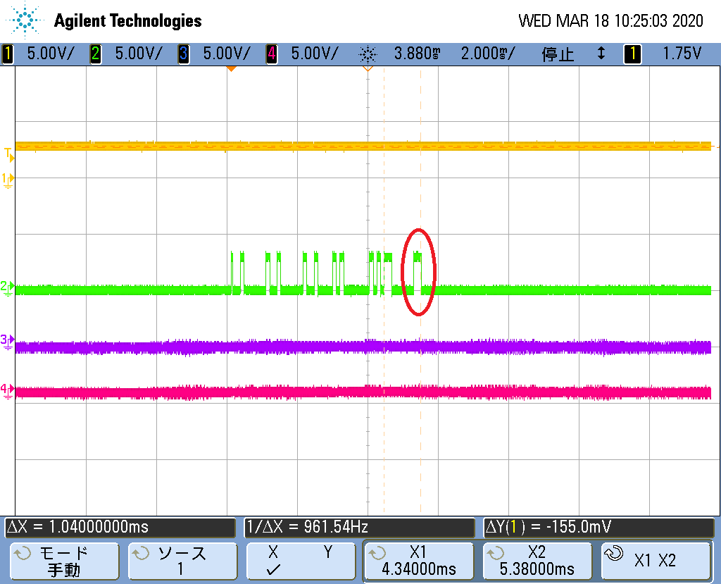

The stop bit of the last character is short in the Uart output part, and the other MPUy cannot receive the character.
How do I fix it until I send the STOP bit completely?
The waveform and the transmission program are described below.

  • Try waiting for EVENTS_STOPPED after staring the stop task with TASKS_STOPTX;

    Did you configure the TX pin as "output high", i.e. set the corresponding bit to 1 in the GPIO output register?
    What is PIN_UART_SENDING? Is this the TX pin of the UART peripheral, or is it a separate GPIO?
    Can you post the entire application so we can see the UART config and how you call this function?

    Between the controller MPU and the nRF52, in addition to the UART, a GPIO that can be used as an interrupt is input and one for output is assigned as a Strobe signal for UART transmission. PUN_UART_SENDING means bit 29 of GPIO.
    A part of the uart initialization and configuration excerpt is described below.
