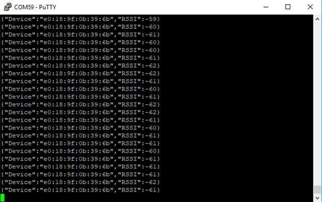

pca10059 - Read battery level from BLE Event (Beacon Advertise)
Im using pca10059 to scan for near beacons address and RSSI, but i also want to look for its battery level. (im using pca10056 to develop and debug)
I've found some posts here talking about checking its own battery, as a peripheral. But in my case its working as a central, i managed to modify usbd_ble_uart example to get address and rssi.
This is the section of the code when i read the address and rssi and send it to the usbd serial port, when ble_evt is BLE_GAP_EVT_ADV_REPORT:

         case BLE_GAP_EVT_ADV_REPORT:
           if( p_ble_evt->evt.gap_evt.params.adv_report.data.p_data[5] == 0xAA &&  p_ble_evt->evt.gap_evt.params.adv_report.data.p_data[6] == 0xFE ){
            size_t size = sprintf(m_tx_buffer, "{\"Device\":\"%02x:%02x:%02x:%02x:%02x:%02x\",\"RSSI\":%d}\r\n", p_ble_evt->evt.gap_evt.params.adv_report.peer_addr.addr[5],
                                                                       p_ble_evt->evt.gap_evt.params.adv_report.peer_addr.addr[4],
                                                                       p_ble_evt->evt.gap_evt.params.adv_report.peer_addr.addr[3],
                                                                       p_ble_evt->evt.gap_evt.params.adv_report.peer_addr.addr[2],
                                                                        p_ble_evt->evt.gap_evt.params.adv_report.peer_addr.addr[1],
                                                                        p_ble_evt->evt.gap_evt.params.adv_report.peer_addr.addr[0],
                                                                        p_ble_evt->evt.gap_evt.params.adv_report.rssi);
            ret = app_usbd_cdc_acm_write(&m_app_cdc_acm, m_tx_buffer, size);
How can i read the battery level of the peripheral as well?
my actual output is like this:

  • Hi
    Yes, this should be possible. You can add the battery level to the advertising data, and update the advertising data on each SAADC callback. Seeing as you already have quite a bit of data in your advertisement, you might have to add the battery service data in a scan response packet, as the advertising packet can only contain 31 bytes of data.
    This (rather old) example already does this. It uses an app_timer to trigger a periodic timeout where it uses the ADC to measure the battery level and update the advertising data with the new battery values. You can use that as a guide.
    Simon
