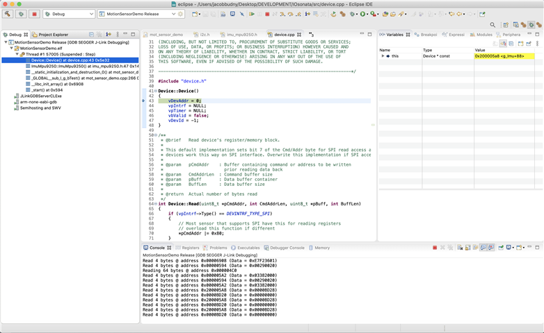

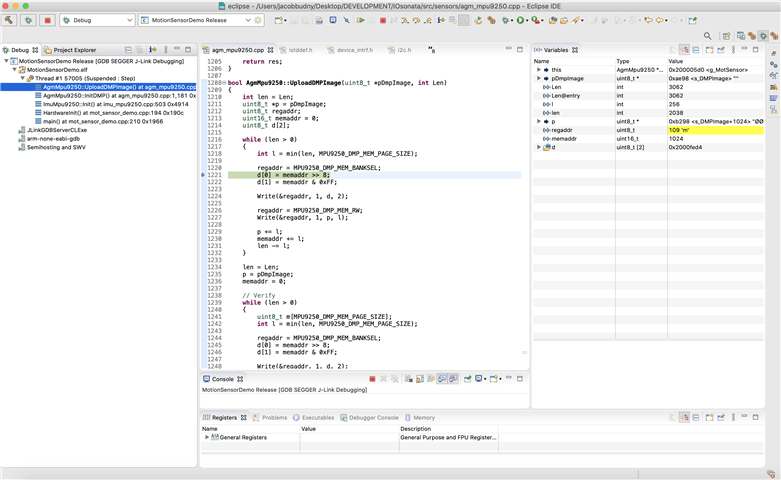

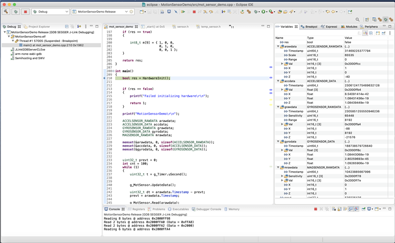

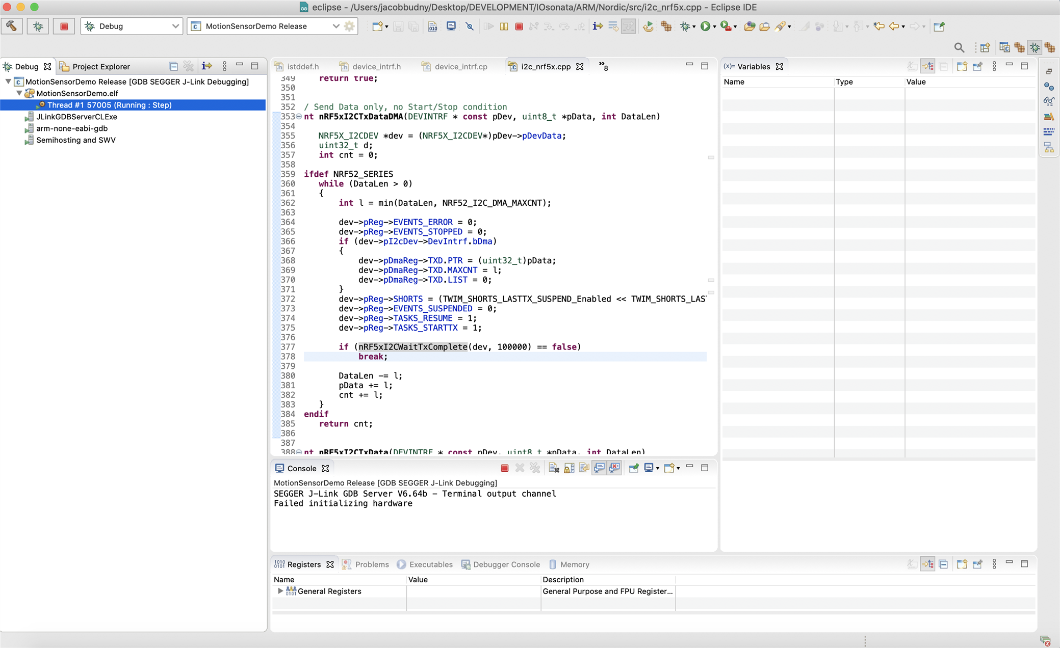

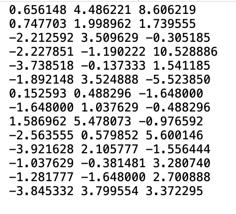

  • How now get the values from magnetometer since I got gyro and accel working?
    in Hardware init, this function:
    if (res == true)
    		res = g_MotSensor.Init(s_MagCfg, &g_I2c, &g_Timer);
    		if (res == true)
    			g_pMag = &g_MotSensor;
    makes res false
    this is my whole code

  • Init seems fine.  I don't have the MPU on i2c interface.  I don't know what is going onbut I do know that it works in SPI.  There must be some setting or a different way to read.  Do you get the mag chip ID ?
