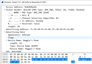

I have a BLE device for which the local name contains and apostrophe. When I run nRF Connect on an Android phone and view the raw data for this device I find the apostrophe is represented by the following three hex bytes: 0x80 0x99 0x73. I am developing an App that reads the local name and I find the same 3 bytes for this device at the location of the apostrophe in the scan report data. I am curious as to how you came to interpret these 3 bytes as an apostrophe when that is usually represented by the single Ascii byte 0x27?

    Could you please provide me a more exact description of the issue - with a screenshot of the "raw data for this device" and the scan report data, along with the device name in question?

  • As you can see from the nRF Connect images above there is a device "Maggie's Room" for which the Raw Data in the first line has the hex bytes "0xe2 0x80 0x99" in between the 'e' (ox65) and the 's' (0x73) where the apostrophe is. The hex value for an Ascii apostrophe is 0x27 and is only one byte. In my code I retrieve the same raw data but the apostrophe gets displayed as three extended Ascii characters that look like garbage in the output. So my question is how do those three bytes get interpreted and properly displayed as an apostrophe in your nRF Connect code?
    I am unable to reproduce this on my end - when inputting a ' it is written as 0x27 in the raw data, as can be seen in the attached screendump. I tested this with nRF Connect as well, with the same result. Therefore, I strongly suspect that the inputted character is in fact not an apostrophe.
    Upon further investigation, your inputted character - 0xE2 0x80 0x99 - is in fact a UTF-8 right single quotation mark .
    This explains why it is rendered similar to an apostrophe, while it is not.
    If you run into similar problems in the future, I recommend looking them up in a unicode lookup table for the fastest possible resolve.
    Let me know if you should have any other questions! :)
    Karl
