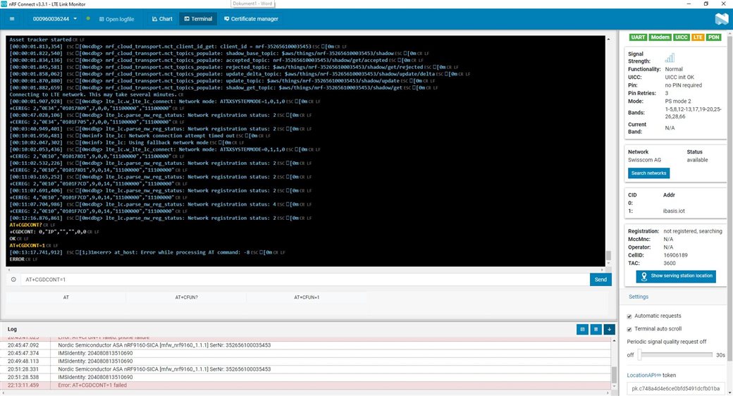

Cant reconnect to nrfcloud/LTE network even though iBasis eSIM has been registered and already sent data
I am trying to better understand the eSIM provisioning process.
I want to verify that the IMSI changes to a local profile after the first registration with the provisioning profile, since this is what the eSIM is supposed to do.
For that I am trying to connect to the nrfcloud with the nrf9160 (mfw_nrf9160_1.1.1 with the asset tracker app on it.
I followed the instructions to add my device on the nrfcloud and also registered my iBasis eSIM during the process.
I encountered the following problems.
1. I was not able to add the device to the nrfcloud but it shows that data has been used from the registered eSIM. Because of the used data I take it that the device has been connected (but not successfully added) to the nrfcloud at some point. Am I right with this assumtion?
2. Since then, I am unable to (re-?)connect to the nrfcloud again.
I know from other eSIM that sometimes the APN has to be reset after the first registration of the eSIM. (Which apparently occurred due to the used data.)
I suspect that this might have happened with the iBasis eSIM as well and thats why I am not able to connect to the nrfcloud again.
Because when I query the PDP context I receive the following.
AT+CGDCONT?
+CGDCONT: 0,"IP","","",0,0
But in the iBasis Global Access for Things FAQs it says to use the APN: ibasis.iot which i see is not set in the PDP context. (3rd parameter " ")
if this is the problem, how can I set the APN to ibasis.iot and reconnect to the cloud?
I have already tried to define a new PDP context as shown below but I was not able to activate it.
AT+CGDCONT= 1,"IP","ibasis.iot","0.0.0.0",0,0
OK
AT+CGACT=1,1
+CME ERROR: 176
3. I noticed that the IMSI did not change. Does this mean, that the eSIM does only send data over roaming and does not really switch profiles?
Attached you find the LTE link monitor screenshot as well as the log file.
Best regards, Lea

2020-03-30T20:59:57.188Z DEBUG modem << Connecting to LTE network. This may take several minutes.\x0D\x0A
2020-03-30T20:59:57.205Z DEBUG modem << [00:00:00.485,046] \x1B[0m<dbg> lte_lc.w_lte_lc_connect: Network mode: AT%XSYSTEMMODE=1,0,1,0\x1B[0m\x0D\x0A
2020-03-30T21:00:04.676Z DEBUG modem >> AT+CFUN=1\x0D\x0A
2020-03-30T21:00:04.680Z DEBUG modem << OK\x0D\x0A
2020-03-30T21:00:06.048Z DEBUG modem >> AT+CFUN?\x0D\x0A
2020-03-30T21:00:06.053Z DEBUG modem << +CFUN: 1\x0D
2020-03-30T21:00:06.062Z DEBUG modem << OK\x0D\x0A
2020-03-30T21:00:06.070Z DEBUG modem >> AT+CGSN=1\x0D\x0A
2020-03-30T21:00:06.076Z DEBUG modem << +CGSN: "352656100035453"\x0D\x0A
2020-03-30T21:00:06.078Z DEBUG modem << OK\x0D\x0A
2020-03-30T21:00:06.086Z DEBUG modem >> AT+CGMI\x0D\x0A
2020-03-30T21:00:06.092Z DEBUG modem << Nordic Semiconductor ASA\x0D
2020-03-30T21:00:06.093Z DEBUG modem << \x0A
2020-03-30T21:00:06.094Z DEBUG modem << OK\x0D\x0A
2020-03-30T21:00:06.101Z DEBUG modem >> AT+CGMM\x0D\x0A
2020-03-30T21:00:06.106Z DEBUG modem << nRF9160-SICA\x0D\x0A
2020-03-30T21:00:06.108Z DEBUG modem << OK\x0D\x0A
2020-03-30T21:00:06.111Z DEBUG modem >> AT+CGMR\x0D\x0A
2020-03-30T21:00:06.121Z DEBUG modem << mfw_nrf9160_1.1.1\x0D\x0A
2020-03-30T21:00:06.122Z DEBUG modem << OK\x0D\x0A
2020-03-30T21:00:06.123Z INFO Nordic Semiconductor ASA nRF9160-SICA [mfw_nrf9160_1.1.1] SerNr: 352656100035453
2020-03-30T21:00:06.125Z DEBUG modem >> AT+CEMODE?\x0D\x0A
2020-03-30T21:00:06.130Z DEBUG modem << +CEMODE: 2\x0D\x0A
2020-03-30T21:00:06.138Z DEBUG modem << OK\x0D\x0A
2020-03-30T21:00:06.145Z DEBUG modem >> AT%XCBAND=?\x0D\x0A
2020-03-30T21:00:06.155Z DEBUG modem << %XCBAND: (1,2,3,4,5,8,12,13,14,17,18,19,20,25,26,28,66)\x0D\x0A
2020-03-30T21:00:06.156Z DEBUG modem << OK\x0D\x0A
2020-03-30T21:00:06.161Z DEBUG modem >> AT+CMEE?\x0D\x0A
2020-03-30T21:00:06.171Z DEBUG modem << +CMEE: 0\x0D\x0A
2020-03-30T21:00:06.172Z DEBUG modem << OK\x0D\x0A
2020-03-30T21:00:06.174Z DEBUG modem >> AT+CMEE=1\x0D\x0A
2020-03-30T21:00:06.178Z DEBUG modem << OK\x0D\x0A
2020-03-30T21:00:06.185Z DEBUG modem >> AT+CNEC?\x0D\x0A
2020-03-30T21:00:06.190Z DEBUG modem << +CNEC: 0\x0D\x0A
2020-03-30T21:00:06.192Z DEBUG modem << OK\x0D\x0A
2020-03-30T21:00:06.194Z DEBUG modem >> AT+CNEC=24\x0D\x0A
2020-03-30T21:00:06.202Z DEBUG modem << OK\x0D\x0A
2020-03-30T21:00:06.204Z DEBUG modem >> AT+CGEREP?\x0D\x0A
2020-03-30T21:00:06.210Z DEBUG modem << +CGEREP: 0,0\x0D\x0A
2020-03-30T21:00:06.210Z DEBUG modem << OK\x0D\x0A
2020-03-30T21:00:06.213Z DEBUG modem >> AT+CGDCONT?\x0D\x0A
2020-03-30T21:00:06.220Z DEBUG modem << OK\x0D\x0A
2020-03-30T21:00:06.222Z DEBUG modem >> AT+CGACT?\x0D\x0A
2020-03-30T21:00:06.229Z DEBUG modem << OK\x0D\x0A
2020-03-30T21:00:06.236Z DEBUG modem >> AT+CGEREP=1\x0D\x0A
2020-03-30T21:00:06.241Z DEBUG modem << OK\x0D\x0A
2020-03-30T21:00:06.244Z DEBUG modem >> AT+CIND=1,1,1\x0D\x0A
2020-03-30T21:00:06.253Z DEBUG modem << OK\x0D\x0A
2020-03-30T21:00:06.255Z DEBUG modem >> AT+CEREG=2\x0D\x0A
2020-03-30T21:00:06.260Z DEBUG modem << OK\x0D\x0A
2020-03-30T21:00:06.262Z DEBUG modem >> AT+CEREG?\x0D\x0A
2020-03-30T21:00:06.271Z DEBUG modem << +CEREG: 2,4,"FFFE","FFFFFFFF",7\x0D\x0A
2020-03-30T21:00:06.272Z DEBUG modem << OK\x0D\x0A
2020-03-30T21:00:06.285Z DEBUG modem >> AT%CESQ=1\x0D\x0A
2020-03-30T21:00:06.289Z DEBUG modem << OK\x0D\x0A
2020-03-30T21:00:06.293Z DEBUG modem >> AT+CESQ\x0D\x0A
2020-03-30T21:00:06.304Z DEBUG modem << +CESQ: 99,99,255,255,255,255\x0D\x0A
2020-03-30T21:00:06.305Z DEBUG modem << OK\x0D\x0A
2020-03-30T21:00:06.314Z DEBUG modem >> AT%XSIM=1\x0D\x0A
2020-03-30T21:00:06.321Z DEBUG modem << OK\x0D\x0A
2020-03-30T21:00:06.323Z DEBUG modem >> AT%XSIM?\x0D\x0A
2020-03-30T21:00:06.328Z DEBUG modem << %XSIM: 1\x0D\x0A
2020-03-30T21:00:06.329Z DEBUG modem << OK\x0D\x0A
2020-03-30T21:00:06.339Z DEBUG modem >> AT+CPIN?\x0D\x0A
2020-03-30T21:00:06.345Z DEBUG modem << +CPIN: READY\x0D\x0A
2020-03-30T21:00:06.346Z DEBUG modem << OK\x0D\x0A
2020-03-30T21:00:06.357Z DEBUG modem >> AT+CPINR="SIM PIN"\x0D\x0A
2020-03-30T21:00:06.370Z DEBUG modem << +CPINR: "SIM PIN",3\x0D\x0A
2020-03-30T21:00:06.371Z DEBUG modem << OK\x0D\x0A
2020-03-30T21:00:06.379Z DEBUG modem >> AT+CIMI\x0D\x0A
2020-03-30T21:00:06.388Z DEBUG modem << 204080813510690\x0D\x0A
2020-03-30T21:00:06.390Z DEBUG modem << OK\x0D\x0A
2020-03-30T21:00:06.392Z INFO IMSIdentity: 204080813510690
2020-03-30T21:00:26.854Z DEBUG modem >> AT+CGDCONT?\x0D\x0A
2020-03-30T21:00:26.861Z DEBUG modem << OK\x0D\x0A
2020-03-30T21:00:42.327Z DEBUG modem << %CESQ: 56,2,21,3\x0D\x0A
2020-03-30T21:00:42.336Z DEBUG modem << +CEREG: 2,"0E34","01017809",7\x0D\x0A
2020-03-30T21:00:42.342Z DEBUG modem << [00:00:45.621,154] \x1B[0m<dbg> lte_lc.parse_nw_reg_status: Network registration status: 2\x1B[0m\x0D\x0A
2020-03-30T21:00:42.553Z DEBUG modem << %CESQ: 50,2,21,3\x0D\x0A
2020-03-30T21:00:42.954Z DEBUG modem << %CESQ: 50,2,16,2\x0D\x0A
2020-03-30T21:00:49.278Z DEBUG modem >> AT+CGDCONT?\x0D\x0A
2020-03-30T21:00:49.284Z DEBUG modem << +CGDCONT: 0,"IP","","",0,0\x0D\x0A
2020-03-30T21:00:49.291Z DEBUG modem << OK\x0D\x0A
2020-03-30T21:01:30.958Z DEBUG modem >> AT+CGACT=1,0\x0D\x0A
2020-03-30T21:01:30.976Z DEBUG modem << +CME ERROR: 176\x0D\x0A
2020-03-30T21:01:30.978Z ERROR Error: AT+CGACT=1,0
 failed: Protocol error, unspecified
2020-03-30T21:01:49.324Z DEBUG modem << %CESQ: 50,2,21,3\x0D\x0A
2020-03-30T21:01:54.765Z DEBUG modem << %CESQ: 50,2,16,2\x0D\x0A
2020-03-30T21:02:10.006Z DEBUG modem << %CESQ: 50,2,21,3\x0D\x0A
2020-03-30T21:02:13.325Z DEBUG modem << %CESQ: 50,2,16,2\x0D\x0A
2020-03-30T21:02:21.966Z DEBUG modem << %CESQ: 50,2,21,3\x0D\x0A
2020-03-30T21:02:22.803Z DEBUG modem << %CESQ: 50,2,16,2\x0D
2020-03-30T21:02:33.566Z DEBUG modem >> AT+CGDCONT= 1,"IP","ibasis.iot","0.0.0.0",0,0\x0D\x0A
2020-03-30T21:02:33.574Z DEBUG modem << OK\x0D\x0A
2020-03-30T21:02:40.524Z DEBUG modem << %CESQ: 50,2,21,3\x0D\x0A
2020-03-30T21:02:43.245Z DEBUG modem >> AT+CGDCONT?\x0D\x0A
2020-03-30T21:02:43.260Z DEBUG modem << +CGDCONT: 0,"IP","","",0,0\x0D\x0A
2020-03-30T21:02:43.272Z DEBUG modem << +CGDCONT: 1,"IP","ibasis.iot","",0,0\x0D\x0A
2020-03-30T21:02:43.275Z DEBUG modem << OK\x0D\x0A
2020-03-30T21:02:44.365Z DEBUG modem << %CESQ: 50,2,16,2\x0D\x0A
2020-03-30T21:02:59.798Z DEBUG modem >> AT+CGACT=1,1\x0D\x0A
2020-03-30T21:02:59.814Z DEBUG modem << +CME ERROR: 176\x0D\x0A
2020-03-30T21:02:59.815Z ERROR Error: AT+CGACT=1,1
