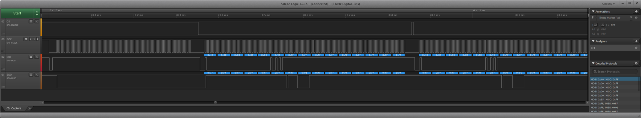

I'm using the unmodified  fatfs example in SDK16 with PCA10040 dev board connected to a Mikroe SD-Click board which is nothing more than a breakout board for microSD cards
https://download.mikroe.com/documents/add-on-boards/click/microsd/microsd-click-schematic.pdf
Connections are as the example
CS    P0.22
DI     P0.23
D0   P0.24
CLK     P0.25
I also bridged the jumper SB10 to bypass the polarity reversal protection diode, so the SD board gets the full 3.3v supply (it was 2.8v)
But all I get is  "Disk initialization failed"
After connecting a logic analyser I can see what looks like correct activity. I see a write command 0x00 (0x40 byte written), then after about 0.25ms the card responds with 0x01 so the physical connections seem OK. Also I tried with both a regular Sandisk card and an industrial spec ATP card with same result.
Where can I look next? I've also attached my logic analyser screen shot.
Thanks
Nick

  • Hi Kenneth
    Thanks for the quick reply. The error was 1 - R/W failure, and the problem was sdk_config.h:
    NRF_SPI_DRV_MISO_PULLUP_CFG was set to pull down; change to NRF_GPIO_PIN_NOPULL and it works OK now including writing to the text file.
    A couple of things. 1) Is this a bug in the example? Not sure why you'd need pull downs. also 2) Wouldn't it be helpful to put the error codes in the application logging?
    Anyway, working now thanks.
