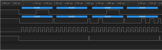

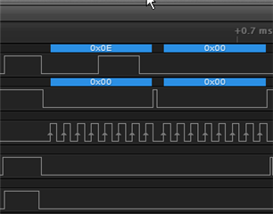

1) I can not find the reply section in the data sheet, I just do not remember where it is. I get the 0x0e, 0x00 with most all address rights except 0x20, that one gives me an 0xe7 on the first byte.
send 0x20 (reply 0x0e) send 0x0a (reply:0xe7)
where can I look up the e7?

/////////////////my init////////////////////
Enable();
sendCommand(0x20);sendCommand(0x0A);//Config : 00001010 enalbe crc, crc 1 byte, power up, ptx
Disable();

Enable();
sendCommand(0x00);sendCommand(0);//read Config
Disable();

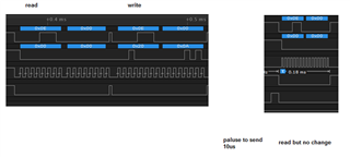

////////////////send//////////// - this will loop
Enable();
sendCommand(0x31);sendCommand(size);// size for data
Disable();
Enable();
sendCommand(0xa0);sendCommand(data); //0xb0 for no ack
//other bytes here.
Disable();
pulse();
/////////////send end/////////
