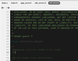

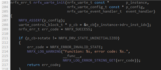

I found similar questions, but none that were marked as "answered".
I have a working version of "nRF5_SDK_160.0.0_98a08e2/examples/ble_peripheral/ble_app_uart". I also have a modified "nRF5_SDK_160.0.0_98a08e2/examples/peripheral/twi_sensor" that works to communicate with my TWI device. I am using Segger IDE.
I am attempting to merge the two projects into one by starting from the BLE and added the TWI components. TL;DR Why can't I merge these two projects to get a functional program?
In partial merge 1, nothing compiles with error "undefined reference to `nrf_log_backend_uart_init"
To fix this, I added more values to emProject and called it partial merge 2. Without yet attempting to communicate with the TWI board, everything compiles fine. But when I run the program, I hit "app_error_handler_gcc.c/app_error_handler(ret_code_t error_code, uint32_t line_num, const uint8_t * p_file_name) with error code 0x08.
To fix this, I added the final missing parts to the .emProject, which causes the error "'NRF_SUCCESS' undeclared (first use in this function); did you mean 'NRFX_SUCCESS'?"
Partial merge 1 means
- main.c/main.h now initializes the TWI communication as well as handle the nRF52840 UART initialization process.
- The bluetooth control has been moved to its own file
- The TWI initialization driver has been added to the "ble_app_uart" from the working "twi_sensor" example
- the .emProject File has been updated (see "ble_twi-partialMerge1.emProject.txt" since .emProject files won't load)
- The Nordic drivers are moved into their own file so that the project is kept clean (nRF_files and Segger_files)
- The missing includes from "twi_sensor" have NOT been added to "ble_app_uart"
- The sdk_config.h file has been updated with everything from both files (see "sdk_config-ble_only.h" and "sdk_config-twi_added.h")
Partial merge 2 means (same as partial 1 except...)
- .emProject (see "ble_twi-partialMerge2.emProject" since .emProject files won't load)
- Some of the missing includes from "twi_sensor" HAVE been added to "ble_app_uart"
- to "<folder Name="nRF_Drivers">"
- File <file file_name="nRF_sdk/integration/nrfx/legacy/nrf_drv_twi.c" /> is added
- File <file file_name="nRF_sdk/modules/nrfx/drivers/src/nrfx_twi.c" /> is added
- File <file file_name="nRF_sdk/modules/nrfx/drivers/src/nrfx_twim.c" /> is added
- to "<folder Name="nRF_Log">" the value "<file file_name="nRF_sdk/components/libraries/log/src/nrf_log_backend_uart.c" />" is added
Complete merge means (same as partial 2, except...)
- .emProject (see "ble_twi-completeMerge.emProject" since .emProject files won't load)
- All the missing includes from "twi_sensor" HAVE been added to "ble_app_uart"
- to "configuration/c_preprocessor_definitions" the value "BSP_DEFINES_ONLY;" is added
- to "configuration/c_user_include_directories" the value "nRF_sdk/components/drivers_nrf/nrf_soc_nosd;" is added
