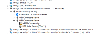

If I take a look into the device manager, I see:
From other threads on devzone, I gather that it should look something more like:
So it feels like a driver issue. I tried to manually update the driver as discussed at:
https://devzone.nordicsemi.com/f/nordic-q-a/18592/is-there-a-windows-driver-for-the-nrf52840-usb-cdc-acm
And Windows tells me that either I already have proper drivers (if I attempt to update Ports (COM & LPT) or cannot find a driver if I attempt to update the "nRF52 Connectivity" driver.

  • Success!
    As you requested, I uninstalled and reinstalled nRF Connect and I noticed a dialog came up that asked me if I wanted to install an USB CDC ACM driver. (I wish I would have taken a snapshot for the record). But anyway, I said yes and now my dongle is properly detected by my PC.
    I am sure I would have hit yes during the first install but I don't recall if the dialog came up then.
    Thanks for the help. I consider this issue solved.
  • For the record, this is what my device manager now reports:
