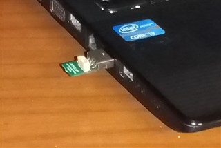

  • Can you post a picture of your setup please? If you're using stock, unchanged modules and have not changed any of the register values, there's no reason for this short range.

    Can you post a picture of your setup please? There's something seriously wrong with your setup that causes this.
  • Here are some photos on how devices are used. There are less than 2m from TX and RX and the transmission is fine only if no one is moving in between. If someone is sitting on the chair we can observe delays of some seconds and the data flowing is non linear.
    If one of the PC is 6m away from the other (in the same room) the transmission never begin.
    The TX is the one with the USB cable.
