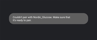

Hi, I'm having trouble pairing with Android devices using the SDK's ble_app_gls example, when I try to pairing
with any andoid device it throws the following error "couldn't pair with Nordic_glucose.Make sure that it's ready to pair".
How to initiate pairing and resolve this problem?

    I try to make the pairing with Android devices, the error appear when l try the enter password in the mobile and It does not allow me to pair with the BLE.
    Could you provide the log with the terminal tool and nRF Connect? You also could enable #define NRF_LOG_BACKEND_RTT_ENABLED 1 in the sdk_config.h, then you could see/get the log in the Segger/Debug Terminal window.
