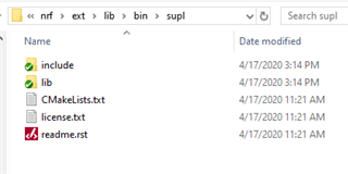

  • Hi
    Are you certain that you integrated the SUPL library correctly?
    How to ensure this? I download the library from your site and put them into "nrf\ext\lib\bin\supl"
     What I meant was how you had included it in your application. But yes, you have put the library in the right place.
