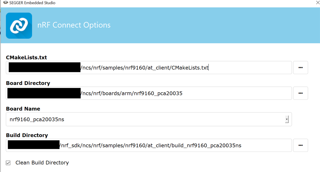

I want to test my iBasis SIM card for NB-IoT with nRF9160DK. So, I tested with the "AT_client" example. I have followed "Getting Start with nRF8160 DK" instruction and I was be able to build and flash without an error.

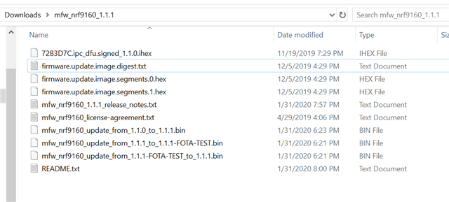

nRF Connect version => 3.3.2

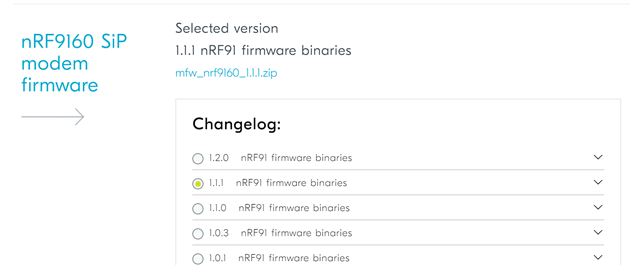

Modem firmware version => 1.1.1
myboard : PCA10090

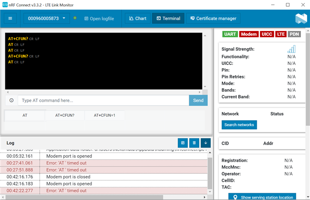

But, It has some problem. I'm still not be able to get any response from the board with AT command.
When I watched this video "LTE Link Monitor introduction" which it also used AT client firmware too. I noticed that I got no message on LTE monitor about zephyr OS booting after pressed the reset button like in the video as shown here...
https://www.youtube.com/watch?v=m5V4Vo_Xemk
Could you please help me solve this problem?
