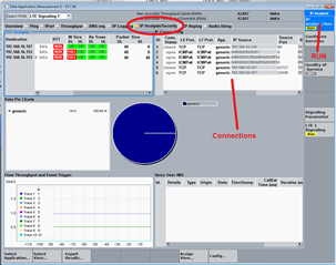

i want to start evaluating FTP client in nrf9160 SoC.  Can you provide an example code for FTP client mode.
  • Hi, it is my understanding that you are using a CMW500 callbox to do the testing? Based on the IP address of your FTP server, 192.168.1.80, I assume that the FTP server is on your local network and you want the nRF91 to be communicating with this server through the CMW500. So first I want to be sure that you have setup the CMW500 Data Application Unit properly in order to communicate with your local network.
    First make sure that your local network is connected to the "LAN DAU" network port on the back side of the CMW500.
    1. Go to the Setup dialog
    2. System section
    3. Click on Go to config, to configure DAU
    4. Open the IP Config tab
    5. Click on Config at the bottom
    6. In the address configuration you can select "DHCP from LAN". Now the DAU and the connected LTE devices will get the IP configuration from the local network. Click apply, and OK.
    7. Verify that the DAU IP address matches the local network subnet.
    In the signaling task, after the LTE devices has connected, verity that the given IP address matches the local network subnet:
    Also make sure that the "connection type" is set to "Data application" in the Config window:
    Now you should be able to communicate with the local FTP server through the FTP client example.
    For more information about configuring the CMW500, please refer to the R&S CMW500 user manual or the R&S CMW Data Application Unit user manual.
  • Hi Stian,
    I have configured Call box as you mentioned.
    but i still not able to connect .
    I have even tried with new hex file (13.05.hex) shared on Serial lte modem i could not able to connect for the TCP server.
    Please find the logs in attachments.

  • Hi Praveen,
    What is the IP address of the nRF91 and what is the IP address of the DAU unit? Have you confirmed that they are on the same subnet? Did the nRF91 also get an IP from the same subnet?
    Did you connect a network cable to the DAU unit, not just the remote control port? You will usually need two network cables connected to the CMW500. One for remote access, and one separate for the DAU unit.
    If you open a "Data Application Measurement" you can start the "IP Analysis" here you will see all socket connections between the UE and the local network. It will show you the source and destination port/addr for all active connections.
    You can also start a http or ftp server on the CMW500 DAU. Click on the HTTP or FTP tab and start the server. The IP address of these servers is the same as the DAU unit and is shown in the IP Config window:
    Try to open up a connection to port 80 which is the HTTP server and see if that works. In the above example the AT command would be:

  • Hi Praveen,
        AT#XSOCKET=1,1,0
    AT#XCONNECT="192.168.16.149",80
