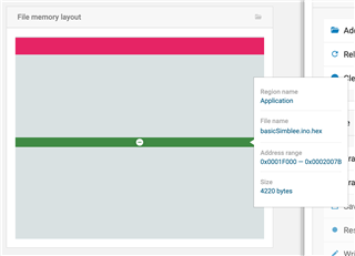

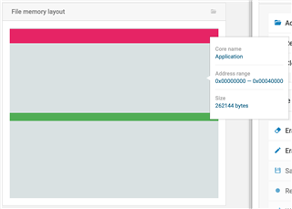

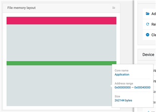

Simblee uses nRF51822 revision 3 and I think has 128K flash. See attached Simblee data sheet (block diagram on page 6).

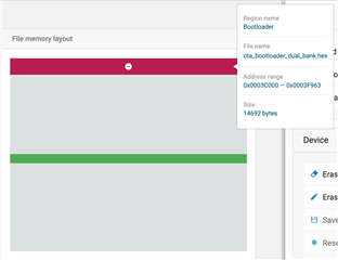

Simblee is flashed using the Arduino IDE and a USB shield. If "#include <ota_bootloader.h>" is in app source, a bootloader capable of legacy DFU over BLE is flashed along with the application. See screen capture of nRF Connect showing legacy DFU service, etc. All 700 devices in the field have OTA bootloader flashed.
I am able to build a new version (hex file) of the Simblee app (using Arduino IDE) and use version 0.5.2 of nrfutil to create a zip file:
nrfutil dfu genpkg new_app.zip --application new_app.hex --application-version 0xffff --dev-revision 0xffff --dev-type 0xffff --sd-req 0xfffe
(Interesting that --sd-req is 0xfffe.) Using iOS-Pods-DFU-Library, I can then use the standard procedure to perform DFU over BLE. Here's the code (objective C):

  • Thanks Edvin. I will pursue both angels: 1) determine the SD required by the current Simblee bootloader (on devices in the field) with the possibility of developing a new app using that Nordic SDK and that SD that can be accepted by current bootloader over BLE, and 2) determine if current Simblee bootloader will accept a new bootloader, which would be a better solution because we would then have control over the bootloader and the DFU process.
    I found buried in the Simblee library these files:
    ota_bootloader_dual_bank.hex
    ota_bootloader_single_bank.hex
    These appear to be the bootloaders that allow either single or dual bank DFU. I built a simple blinky app for Simblee using the Simblee library and Arduino IDE that uses the Simblee bootloader. Then using nRF Connect on macOS I connected to my nRF51 DK, then added the dual bank bootloader and compiled blinky app hex files to the file memory layout and see the following regions:
    Seems odd that they place the bootloader at the top of flash. They've probably done a lot to try and hide much of the layout. Of course the app does not run because there's no SD and MBR.
    Today I will try your suggestion of connecting a Simblee (programmed with app, SD and bootloader) to an nRF51 DK and try reading the device memory layout. Will also try to read the hex files from the device but I speculate that they've disabled flash reading.
