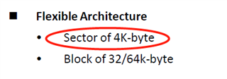

  • Sorry,Fatfs for ffconf.h code:ffconf.h
    #define	_MIN_SS		4096
    #define	_MAX_SS		4096
    /* These options configure the range of sector size to be supported. (512, 1024,
    /  2048 or 4096) Always set both 512 for most systems, all type of memory cards and
    /  harddisk. But a larger value may be required for on-board flash memory and some
    /  type of optical media. When _MAX_SS is larger than _MIN_SS, FatFs is configured
    /  to variable sector size and GET_SECTOR_SIZE command must be implemented to the
    /  disk_ioctl() function. */
    The path of the file is:..\external\fatfs\src
  • Ok, that's great.  Then it shouldn't be a problem.  I didn't it supports larger sector size.  good to know.
