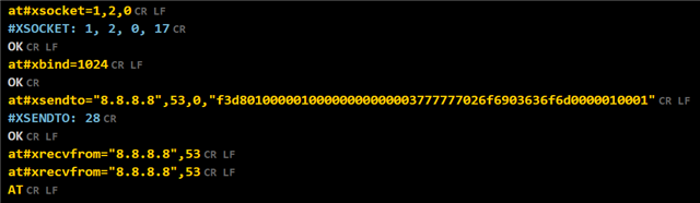

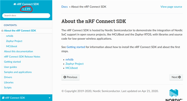

I have been working with the Thingy:91 at the version 1.2.99 but this also happens on previous versions (I do not know which it was but the serial_lte_modem code had a at#xdatatype command that is no longer existing on version 1.2.0 or 1.2.99) of the SDK. In this version I am using the following functions to try to request a timestamp from an NTP server.
at#xsocket=1,2,0
#XSOCKET: 1, 2, 0, 17
OK
at#xbind=1024
OK
at#xsendto="178.32.88.247",123,0,"1b0000000000000000000000000000000000000000000000e2495ab3c7ae147800000000000000000000000000000000"
Ready
The "Ready" at the end means that the device has rebooted, I assume this is due to an error. This happens when the datatype is 0, which means hexadecimal string and the payload is more than 32 bytes,
which in a hex string would mean 64 bytes.
