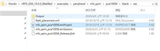

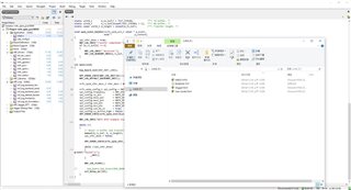

3. Present steps
Step 1 - Go folder [D:\User\Nordic\nRF5_SDK_16.0.0_98a08e2\examples\peripheral\nrfx_spim\pca10056\blank\ses].
Step 2 - Open [nrfx_spim_pca10056.emProject] by {SEGGER Embedded Studio for ARM 4.30c} .

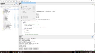

Step 3 - Connect BMD-340 board to PC then turn on the power.
Step 4 - In {SEGGER Embedded Studio for ARM 4.30c} press [Target] -> [Connect J-link].

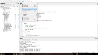

Step 5 - In {SEGGER Embedded Studio for ARM 4.30c} press [Target] -> [Download nrfx_spim_pca10056].

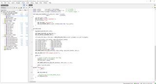

  • Hi, thank you for answering the problem.
    And I added the code you supply, the logic analyzer still detect no signal for SCK , MOSI ...
    This is my [main.c], I added print "Failed!" when stuck in the while loop.
    The debug mode actually keep printing "Failed" Disappointed
    Here is another problem.
     * Copyright (c) 2017 - 2019, Nordic Semiconductor ASA
     * All rights reserved.
    #include "nrfx_spim.h"
    #include "nrf_gpio.h"
    #include "nrf_delay.h"
    #include "boards.h"
    #include "app_error.h"
    #include <string.h>
    #include "nrf_log.h"
    #include "nrf_log_ctrl.h"
    #define NRFX_SPIM_SCK_PIN  3
    #define NRFX_SPIM_MOSI_PIN 4
    #define NRFX_SPIM_MISO_PIN 28
    #define NRFX_SPIM_SS_PIN   29
    #define NRFX_SPIM_DCX_PIN  30
    #define SPI_INSTANCE  3                                           /**< SPI instance index. */
    static const nrfx_spim_t spi = NRFX_SPIM_INSTANCE(SPI_INSTANCE);  /**< SPI instance. */
    static volatile bool spi_xfer_done;  /**< Flag used to indicate that SPI instance completed the transfer. */
    #define TEST_STRING "Nordic123456789012345678901234567890"
    static uint8_t       m_tx_buf[] = TEST_STRING;           /**< TX buffer. */
    static uint8_t       m_rx_buf[sizeof(TEST_STRING) + 1];  /**< RX buffer. */
    static const uint8_t m_length = sizeof(m_tx_buf);        /**< Transfer length. */
    void spim_event_handler(nrfx_spim_evt_t const * p_event,
                           void *                  p_context)
        spi_xfer_done = true;
        NRF_LOG_INFO("Transfer completed.");
        if (m_rx_buf[0] != 0)
            NRF_LOG_INFO(" Received:");
            NRF_LOG_HEXDUMP_INFO(m_rx_buf, strlen((const char *)m_rx_buf));
        nrfx_spim_xfer_desc_t xfer_desc = NRFX_SPIM_XFER_TRX(m_tx_buf, m_length, m_rx_buf, m_length);
        nrfx_spim_config_t spi_config = NRFX_SPIM_DEFAULT_CONFIG;
        spi_config.frequency      = NRF_SPIM_FREQ_1M;
        spi_config.ss_pin         = NRFX_SPIM_SS_PIN;
        spi_config.miso_pin       = NRFX_SPIM_MISO_PIN;
        spi_config.mosi_pin       = NRFX_SPIM_MOSI_PIN;
        spi_config.sck_pin        = NRFX_SPIM_SCK_PIN;
        spi_config.dcx_pin        = NRFX_SPIM_DCX_PIN;
        spi_config.use_hw_ss      = true;
        spi_config.ss_active_high = false;
        APP_ERROR_CHECK(nrfx_spim_init(&spi, &spi_config, spim_event_handler, NULL));
        NRF_LOG_INFO("NRFX SPIM example started.");
        while (1)
            // Reset rx buffer and transfer done flag
            memset(m_rx_buf, 0, m_length);
            spi_xfer_done = 0;//false;
            APP_ERROR_CHECK(nrfx_spim_xfer_dcx(&spi, &xfer_desc, 0, 15));
            while (!spi_xfer_done)
    printf("Failed!\n");
                __WFE();
            NRF_LOG_FLUSH();
    //        bsp_board_led_invert(BSP_BOARD_LED_0);
            nrf_delay_ms(200);

  • Hi
    Again, thank you for being so detailed in your replies! It's not too often we get posts that are this thorough. One thing. When you flash the examples to your EV kit, do you see a "download successful" message like the one below in SES afterwards, to confirm that the firmware has been flashed onto the kit?
    If not, please try to press the Build and Run option in the Build dropdown folder, and see if that flashes the board for you.
    Simon
