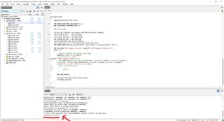

I have got the problem with using BMD-340 demo SPI commuination for many days.
| Problem Describtion   |
1. Developing Tool:
(*) RIGADO BMD-340 Evaluation Kit  BMD-340 datasheet
(*) Module based on Nordic nRF52840
2. Software:   Segger-Embedded-Studio
(*) SEGGER Embedded Studio for ARM 4.30c
(*) nRF5_SDK_16.0.0_98a08e2
(*) Nordic\nRF5_SDK_16.0.0_98a08e2\examples\peripheral
3. Present steps
Step 1 - Go folder [D:\User\Nordic\nRF5_SDK_16.0.0_98a08e2\examples\peripheral\nrfx_spim\pca10056\blank\ses].
Step 2 - Open [nrfx_spim_pca10056.emProject] by {SEGGER Embedded Studio for ARM 4.30c} .
Step 3 - Connect BMD-340 board to PC then turn on the power.
Step 4 - In {SEGGER Embedded Studio for ARM 4.30c} press [Target] -> [Connect J-link].
Step 5 - In {SEGGER Embedded Studio for ARM 4.30c} press [Target] -> [Download nrfx_spim_pca10056].

Step 3 - so that I get string "Nordic123456789012345678901234567890" at BMD-340 GPIO pin 4 because [#define NRFX_SPIM_MOSI_PIN 4] on line 52.
| Logic Analyzer Demo   |
Step 1 - Logic Analyzer connect to BMD-340 GPIOpin4(P0.4 on board) or P0.3
Step 2 - setting analysis rate 100M Hz <-- Must greater than SPI clock rate to get signal
|       Problem         |
1. no matter what PIN in BMD-340 { P0.3(SCK) P0.4(MOSI) P0.28(MISO) P0.29(SS) P0.30(DCX) } cannot trigger logic analyzer
2. I connect probe of analyzer with PIN VCC (5V0) and logic analyzer was triggered with signal 1.
3.  (2) means logic analysis can work and detect signal on port, only SPI definition port has no signal.
|     NEED HELP    |
(*) Can anyone explain does any of above steps wrong?
(*) It just a demo SPI transport function, I have tryed other SPI examples like {spi, spi_master_using_nrf_spi_mmgr, spis} in [/peripheral/] but none of them works.
(*) My project is to use [BMD-340] f_open() file, pass value to [FPGA] with SPI and their pin connected together.
