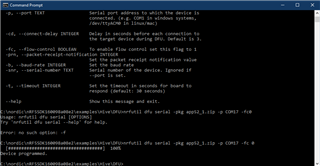

    I also attached the prompt window output and the nrf Connect read image. Hope this help. I noticed that the logger saying the bootloader is jumping to address: 0x00001000 which doesn't match my application start address as I read it from nRFConnect read image. Not sure if this the issue.

    Thank you, this is useful in narrowing down the issue, though I don't understand the problem yet.
